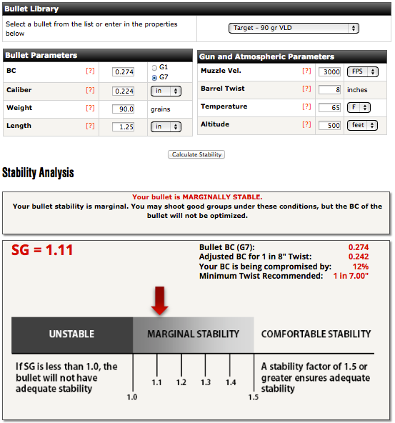

Not sure how much .220 Swift info you will find, but the issue of jacket failure has definitely been addressed. One approach I recall reading about was to use a 7.2 twist barrel, rather than the 7.0 (or below) twist commonly used in .223s. I've played around with the numbers using Berger's twist rate calculator and with the kind of velocity you should be able to get from a .220 Swift, the 90 VLD should still retain an Sg of greater than 1.5 (full BC) in a 7.2 twist barrel. Presumably, the slower twist would be slightly less hard on the jacket. You can use Berger's calculator to determine the values for yourself, but I recall that going much slower than a 7.2 twist began to cut into the Sg enough to lower the effective BC of the bullet. You can get away with that to some extent, but slowing the twist rate too much will cause you to effectively lose enough BC so as to defeat the purpose of using the 90 VLD in the first place.

Sorry...an 8-twist isn't nearly fast enough. Even setting the temp and elevation at 65 degrees and 500 ft, respectively, Berger's twist rate calculator indicates you'd be giving up somewhere in excess of 10% of the theoretical maximum BC of the 90 VLD. Might as well just switch to an 80 gr .224 bullet at that point.
Those are G7 BCs, not G1. For the SMK 90, Berger's calculator estimates you'd be giving up 5% of the theoretical maximum BC (1.171" OAL, 3000 fps, 65 degrees F, 500 ft elevation). That's still enough loss to put it closer in performance to an 80 gr .224 bullet. There is no good reason to go with a twist rate slow enough to do that.
