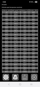

I switched to the 62vt out of my creed.
Here is my ballistic chart.
