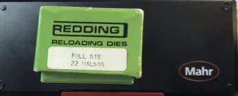

Looks like I have a 22 Short Dog die now. I was have trouble resizing some 22BR brass now that I have shot up all the ammo that I received when I bought the rifle. I thought maybe it had a oversize chamber that's why I was fighting it and when I finally got it full length resized it had a really short body and a really long neck. Go figure and I bought the dies off of here but don't remember from who.

I checked with Dan Dowling, (Accuracy Gunsmithing) he still has reamers. I might give it a go, several of the locals shoot them at 100 and 200 with good success.
