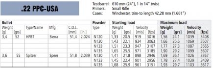

I have a base load of 25 grains LT32 and a 52 grain Berger. Any 22 PPC experienced guys that can tell me what the top end is so I stay away from it? I do not have a chrono and I am not seeing any pressure issues.

My four manuals have no info on 22 PPC. I started at 25 grains. I'm looking for a max load (so I don't get near it)

My manual doesn't have LT32. Here are the MAX it lists:
748 - 29gn
H322 - 25.9gn
N-133 - 24.9gn
AA2230 - 24.6gn
Given that, you can definitely say 29 is too high for LT-32.

But here is what I found in my sierra manual.
Well, the picture is to large to load.
I don't know how to make it smaller.
If you send me a pm with an email or phone #. I can send it over that way
