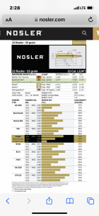

I just got some new boxes of Nosler’s 55 grain ballistic tips and they now rate them at 3500fps from a 18” barrel vs the original 24” barrel test. Have they made the newer loads hotter?

My 22Nosler bolt gun is considerable faster than what is on the box, ymmv.
Listed speed wether it is load data or loaded ammo can vary a huge amount. I pay little attention to what is publicized, they are in it for the selling point for the most part.
I will just be stoked if it even matches specs on box. I’ll be shooting from a 20” Wilson Combat so keeping my fingers crossed. My .223’s from a 16” barrel are no where even close to that number. More like 3000fps so hope to see the extra 500fps for coyote hunting. Guess we will see.

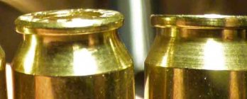

I did have an issue with some earlier Nosler brass. Sharp edges on the rim instead of a bevel.
Would shave brass when the extractor slipped over and leave flakes on the bolt face.
Hand beveled and all is OK. The no-gas gun doesn't rip up brass like some report and the NOSGAR brass with the 224V sized rim does fine. Cut the ejector spring and cut down the gas. Dribbles out cases a foot or two @ 2 o'clock.

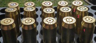

With my No-Gas AR I didn't have issues with swipes or pulled rims like others reported.
Moderate loads, about 2800 -2850fps with 88s I start losing pockets after 5 or so reloads.
Heavier loads, pockets go after 3 reloads. About 10 per 100.
With the wife's gasser, gas turned down low the Hagar brass hardly shows any sign of firing.

The sharp edge I spoke of and my hand bevel Battery drill and file:
