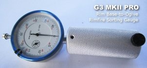

Lee, can you please show your ogive gauge …thanks!

Here is the gauge I use. it was made by Gerry Gereg there was a write up here on AS. Hawkeye Wizard (Ron Elbe) wrote about his experiences using one on RFC.
Unfortunately, it seems that Gerry is either not making them anymore or sadly he may have passed away. his email is still valid, but he has not replied for nearly two years now.
Lee

because I sort by AOL as measured
Because I measure AOL from the rim face to the Ogive I noticed a common occurrence. overly long or short AOL is where I see shots go high or low outside a group. these are the fliers I am speaking of in my case.
of about 20-25,000 rounds I have sorted I noticed the best shooting lots have very few if any of these way off AOL. and will sort in groups of AOL within 0.010 or less. and will have a majority group length with 75-85% out of 500 rounds. which means 425 rounds will be under 0.010 spread I consider 0.005 to be a non-factor when sorting. so, I may have sorted groups of 0.0700-0.705 as an example.
In perspective my rifles like AOL from 0.705-0.725 any round measured that is more than plus or minus 0.015 will be these rounds that shoot high or low. I have found some lots with as much as 0.045+ or 0.045- but even when they are sorted and grouped together, they are predictable on how they shoot.

I was just about to ask if you had shot the outliers , sorted that is, to see if they grouped together. Good info and much appreciated.
Lee
I tried to buy one this winter. He replied with info in the late fall and i mailed him a check to purchase the gauge. I haven’t heard from him since.
