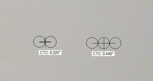

To illustrate for readers in general, below is an example of two holes touching. It uses a bullet hole size of .22". The two holes are .220" center-to-center. When any space appears between two holes they must be further apart than when just touching. The example to the right shows three holes just touching. The farthest apart are .440" center-to-center.

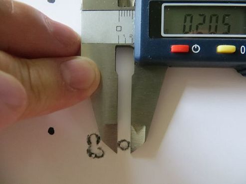

There's a simple explanation for why some groups can be measured smaller, for example two holes just touching measuring less than .220". The actual size of the bullet hole in the target paper is usually less than .220" (or .223").
If the actual bullet hole is smaller than the size used for subtracting from the outside group size, a smaller measurement will be the result.
Below are two measurements of the same bullet hole. The first shows the measurement of the actual bullet hole, including the grey smudge. It will vary according to paper used, but in this case it happens to be .205".
If two of those holes were just touching each other, they would measure on the outside at .205 + .205 = .410". Subtract .220" from that would give .190" ctc. But we know that the two holes just touching would be .205" ctc.

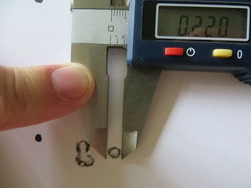

At bottom is the same bullet hole with the calipers showing .220" which is clearly too generous.
