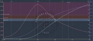

RangeRat I do appreciate your feedback on this. I had not seen any data on 8208xbr in the 22 GT so I ran very conservative test loads from 35gr on up .3 gr apart. When I reached the speeds I had seen using Varget I quit. This was all in alpha brass with 53gr Vmax. Pressure signs to me are flattened primers, firing pin dimples and any increase in bolt lift. The Alpha brass and SR cci 450 primers could very well sustain pressures above wise numbers. Three times through a few pieces of brass and I don’t feel any loosening of primer pockets.
I don’t have a model for a 22 GT in GRT so I run 22-250 at lower lengths and at a capacity of 44.1 gr h2o and even mid level charges modeled at 59kpi are <150 fps faster than expected. This was true for Varget as well as 8208xbr. The Garmin Xero matches well with my old Pact.
Other than a strain gauge on the barrel, how better can I judge pressure?
When you model a 22-250 and set the volume at 44.1 grH2O, with 37.2 gr 8208, 53 VMax, what pressure and speed did you get? I'll try it when I get home.
If you don't strain gage, you can submit loads to a lab that will run a pressure transducer. They may not agree to test unorthodox loads to prevent damage to their systems.
It bothered my so I held off till I got home....
Here is a GRT version to illustrate the concern I was sharing when I saw very similar results from proprietary ballistics models.
If I was to use public domain software like GRT, and I take a 22-250 case from the default volume and force it down to 44.1 gr, with your load and the powder default values the pressure is over 73 ksi and still only generating 3860 fps. By the time you use enough adjustment to the model to get to 4000 fps, the pressure in a 22" bbl will need to be approximately 83.7 ksi. to account for the speed.
That is why I made my warning comment.
It isn't uncommon to have folks pushing the x47 and BR variants way up in speed, but most of the time we are discussing long barrels where slow powders have a chance to integrate pressure over a longer pulse. When getting 4000 fps results in a 22" bbl from a GT case that are even faster than a 22 CM, it caused me to take a pause and wonder how it works unless it is just scary high pressure?
