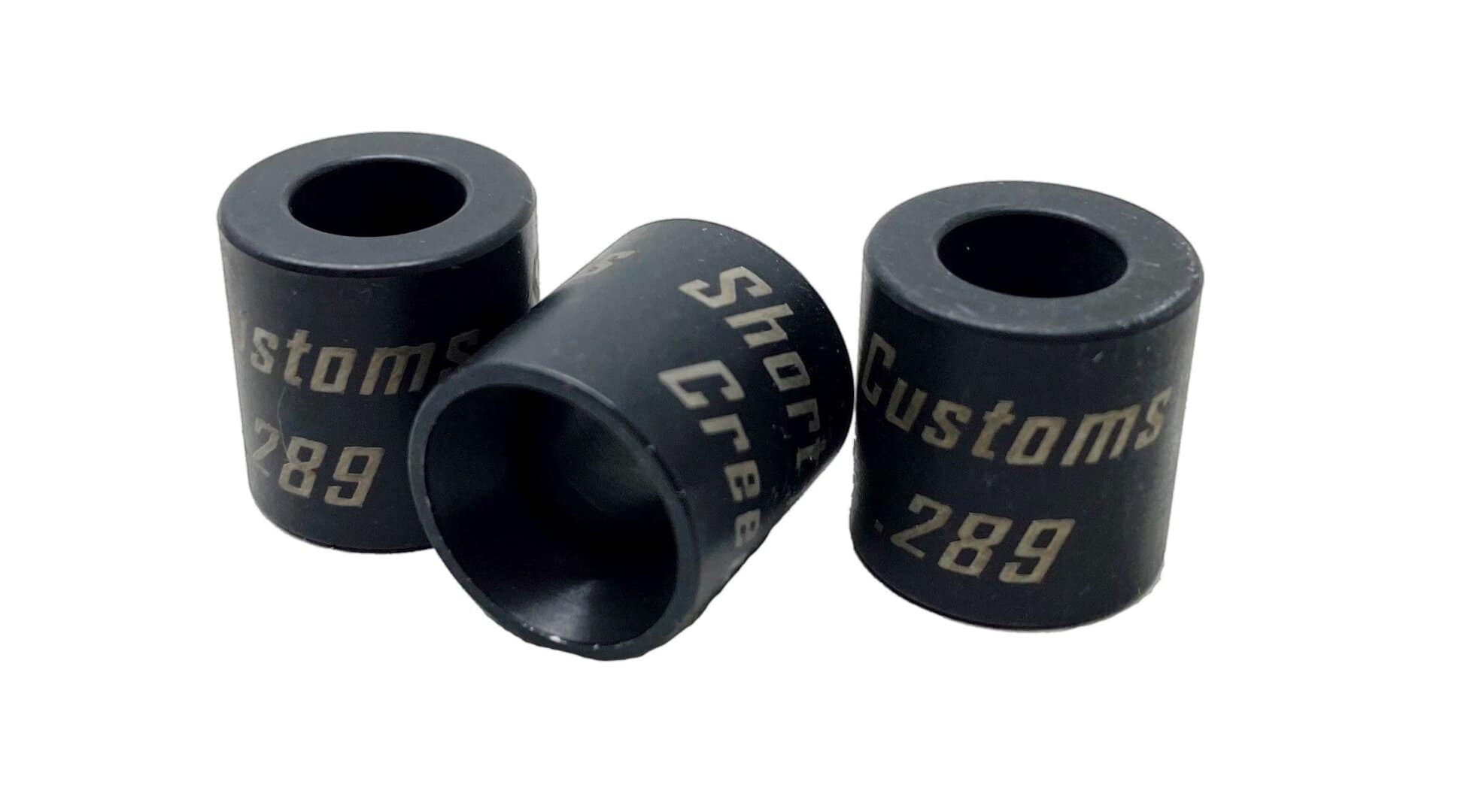

I run Short Action Customs sizing and seating dies
The easy button would be to stick to the 22 Dasher and use your 6 Dasher dies if you are using bushing dies.
I know sac makes quality stuff, but at my age , I'm not spending $350 on one die. I'm not shooting championship matches, and prize money isn't more than $10.00 , so it might be advantageous to look into the br or 22 dasher...rsbhunter
Here a L.E. Wilson 6bra full length bushing sizing die. Just throw in the right 22 bushing and you're ready to roll. I have a few of these dies and they are very nice. They accept Redding bushings as well
1 in stock
Padom, THANK YOU ! It dawned on me about 30 seconds before I read your post. It had honestly escaped me to look for a 6mm brx bushing die....I am going to order one now, the bushing I'll order after I get a fire formed case and can get neck o.d. #'s..Thank you again for taking the time to re-educate me. rsbhunter

padom, thanks again for the info...I did order the Wilson die from Graf's last night. I will order a Forster 22 micro adjust 22 seating stem to use in my Forster 6mm Dasher seating die and bushing when I get the bbl. Had thought alot going with one of the others (22 br or Dasher) but it seems that the brai will do all I need...I really am indebt to all who responded to all of my questions, and were nice enough to respond...Thank you all.....rsbhunter
