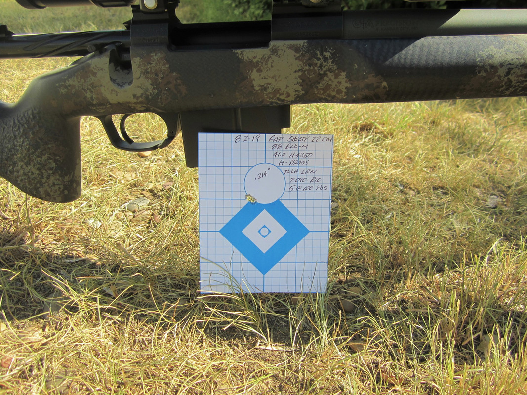

I own 3 wildcats and one of them is the 22 Creedmoor. I must say, there was almost no load development involved. It shot a big, one ragged hole from the start.
You guys are twisting my arm really hard. Couple of good shooting outfits right there.
