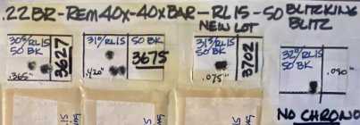

Mine is a 40X rifle / rechambered barrel done in the 80's. At that time cases were made by necking down Rem. 7BR brass and took a bit of time. Chamber spec's were up to the riflebuilder. He was an avid benchrest shooter who also built most of the match guns in that area. I necked down 800 cases and he neckturned them on a lathe.
Rem 40X barrel
,243Nk (not a misprint)
Freebore unknown
50gr BlitzKing
31.5gr RL15 - This powder shot well and works terrific in a 22-250 / 22-250AI, but I think it's quite a bit too slow for the 22br. Still, that's what we used back then. Targets were shot in the 90's when I got a chrono, off the tailgate of my truck, haven't shot it since then. A very accurate round.
