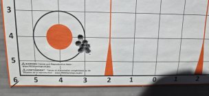

Making 22 ARC is pretty straight forward. I used the method described in this You Tube Video. I made it from Starline Brass. After forming I annealed the brass, ran it through the sizing die again and loaded it.
26.5 grains of Benchmark, 60 grain Vmax, 2.20 OAL, Fed 205 Primer.
It's from a bolt gun. Here's the details on the barrel. I also have two AR barrels coming in 22 ARC. Hopefully they'll shoot as good...
