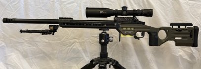

Thanks for posting. Going to pick up a barreled action in 22 arc from the gunsmith tomorrow. I will be looking to shoot 90-95gn pills but any info on a new cartridge is welcome.
Picked up the barreled action today.
28” shillen 6.5 twist, straight, ec tuner, Curtis valor action, mpa matrix chassis with a march 4.5-28 fx/ tr1 reticle. Weights 23 pounds.
Loaded (25) rounds to zero and break in.
95gn SMK, 28.0gn H4350, Hornady brass, federal 205m primers. Hoping for 2800 fps.
Will post results tomorrow.
