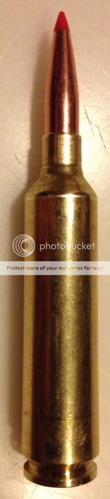

It's coming together! I have a Krieger HV contour 28" 8tw tube, the resizer reamer from PTG and waiting on the Chamber reamer, a bunch of Hornady 80 gr. A-Max, 8 lb. H1000 and cases/seater die/6.5X.284 FL bushing die for stepping down the neck arrived today! Threw a dummy together to see what it will look like, sorta.
Now that's gotta be a barrel burner. How many rounds before the barrel goes south. What kind of speeds can you get using the 80 grain amax?
