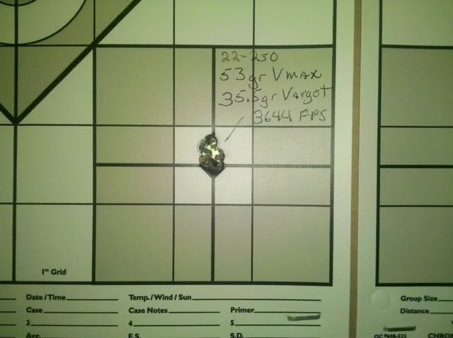

I have a 22-250AI 8 twist and a 12 twist try the 53gr Amax in your 12 twist Im still working up a load in the 12 twist but so far the 53gr Vmax is working pretty good this is the first group with the 53 Vmax
thats a good start there how much more do you need to improve that? what is the load
The load is 35.5 grs Varget 3644 fps avrg I think I can get a little more velocity that load was almost the max for a standard 22-250 but not bad for a fire forming load
Rich,
This is not a bad group at all period, but if this was a fireforming group and if it is repeatable it is excellent so excellent in fact I wouldn't waste one shot fireforming at paper or for no reason, I would be killing GH's while fireforming, obviously a well put together rifle and you have done a good job tuning your fireform load, I hope your full house loads are as accurate, your rifle will be a blast while it lasts.
Wayne.

For fireforming you are going to want plenty of tension, a factory f/l or neck die will give you enough if you have a bushing die I would shoot for around .004-.005 tension, after fireforming if you have bushing dies, I would shoot for about .002 and play from there, if there going to be fed from a Magazine I wouldn't go less then that and that may not be enough, as recoil can push the bullets back into the case and cause EXTREME pressure spikes, you will have to check for problems there. If it will be a single shot you can get by with even less, some powders like less tension and some like more, that is the beauty of bushing dies, you can experiment, hope this helps some.
Wayne.
I love seeing groups like this out of a varmint rifle in the morning, it makes for a wonderful day. I think you ought to take that to a local match, i think you could come away with some of that stuff uncle sam prints off in your pocket.
i have seen some bullets in the 60 to 65 grain area does anyone shoot or have any experience with these i seen a couple with real good bc's in the bullet database on the home page here
Rich,
Wayne.

Thanks, this load is very repetable but even if I can't get much more velocity on it I will be very happy with this load. I have a few AI's a couple of 223's and a 8 twist 22-250AI and am in the process of building another 8 twist 22-250AI on a Stiller action and Kreiger barrel. BTW this was shot with a re chambered factory Savage LRPV

That is simply amazing!
Wayne.
Calib, the BC on the 53 grain Vmax is .290. It is probably going to be the best BC that will stabilize in a 1/12 twist barrel. You should be able to push it nearly as fast as a 50 grain so if your gun likes them, I don't see it getting any better.
Rich, nice shooting. My lrpv 22-250 will shoot like that with n-140 and 50 Vmax. I haven't ran out of loaded rounds yet so I haven't tried the 53 yet. The barrel is starting to foul worse than it used to so I'm hoping it holds on a little longer as I'm not ready to give it up yet.
