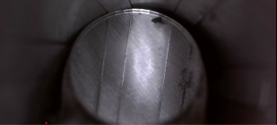

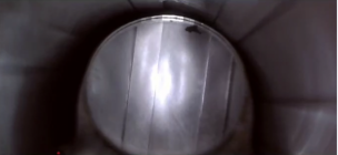

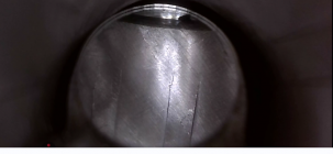

Now for the part I know a lot of y'all love ... The bore scope. This is right out the box no cleaning from the muzzle to the chamber
So I have no clue what this lil squiggles are...I've NEVER seen anything like it

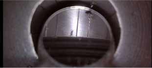

Aannnndd looks like we have a bur where the drill came though for the gas port
More squigglies

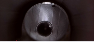

Aannnd the throat... honestly is better then I was expecting for BCA lol
And gave it the usual cleaning i do with a new cheap barrel because they are usually friggen disgusting.
So hoppes #9 wet patches then dry patches then JB bore paste , dry patches , hopes dry JB and a wet patch
Aaannnddd yeah definitely a dect lil bur.... Can't really do much so guess wells see what a few rounds will do lol, those squiggles arent going anywhere it seems

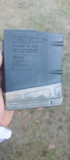

So initial lil test. Got some factory ammo the other day ...which btw eveyone tells me 30-50 GR is the best for this with its 1:14 twist barrel ...but all I saw mostly was 55gr factory ammo...I mean there was some 45 GR vmax stuff from hornady....but yeaaahhh nah not dropping $50 a box for that mess lol
As far as mags: seen a few comments about how these could be mag picky and how there's a few companies making custom or modded mags for these ..... Well one place is out of stock and I'm not paying $150 for the other custom one ..... Nahhh. So just gonna use the same ole mag I used with my creedmore

Ok first up gonna run two rounds from the mag. Will let me test and see how feeding and lock back works and not waste a ton. I tried setting the camera up so y'all could see the round getting picked up buuut didn't work out .
Anyhow mag in rack back and let it run like. AK..no babying .

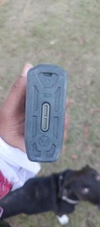

So I thought and remembered that alot where saying if they don't full load a mag they usually had pretty good feeding but a full mag would make round nose dive into the feed ramps..... Ok soooo let's try a full mag.
So 10rd
So racked the bolt the same way annnnd
Shes in!

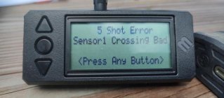

So heres how 100yd worked ,ran five rounds at the center target no adjustment no Chrono graph or anything . One it shows me what the guns will do with a larger group.... Sorry don't trust three found groups the most ... especially with my shooting lol. But also lets me see about what the zeros shift does from 50-100yd. Then I adjusted a bit to try and hit the center and strapped the Magento on and shot three at the left then took it off and three three on the right without any adjustments to the zero.
And
So with the cheapest factory ammo I saw at bass pro...with what's supposed to be a bit too heavy of a bullet....not .. terrible... Not exactly good ..but usable .
No velocity data unfortunately
