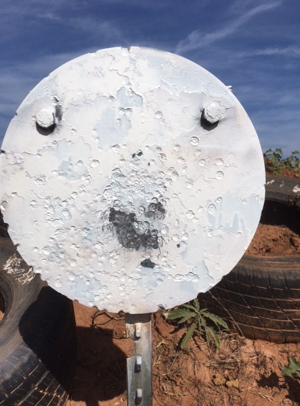

I tried H4350 behind 75gr Amaxes in my 22-250 but had hands down better results from R15. This group is 5 shots at 710 yards,
