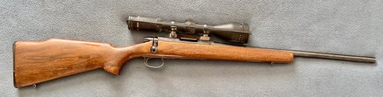

I have a an old wore out 788 .223 that belonged to my grandad I want to do something with at some point. This round has my interest. Is it just a simple one step resize? Think it would be pretty cool on a 1-12 with 52 Bergers/55 SBK's.
The 22-204 would be great. Only thing is, that case won't fit the 788 - 222/223 magazine (they're the same) . Those depressions running down each side, the 204/22-204 shoulder is a bit too far forward. The case wont go into a magazine. Also, the mag isn't really long enough for a bullet with much length or a chamber with any kind of freebore. The shoulder length on 223AI case is just short enough to fit the magazine and appears that it would work, but dont know how well it would feed. The 223AI wasn't around when mine was done, and I didn't have the reamer back then or the old 788 probably would have been made into an Ackley. So it's still a .223, with very minimal and 0 freebore chamber. With good brass you can do quite well with a .223. My old 788 was a 222, rebarrelled with a Rem. 700 /223 re-threadeaded and cut to 20". The accuracy / working load is a 40Vmax @ 3895, with VVpowder, IMI brass. Haven't tried Lapua or LC in this. But a 40 at almost 3900 shoots pretty flat and does a nice job on varmints. Not a pretty thing but is handy at that length and works really well.

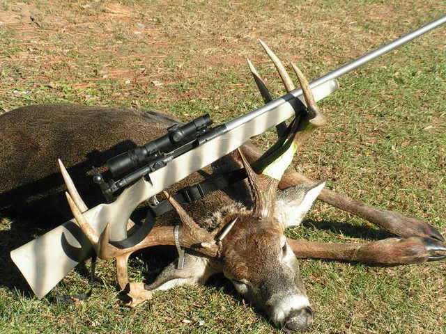

Yes the 25-204 is a fun rifle, pretty much a clone of the 257 Kimber without the fancy case forming. Commercially it was marketed by Gary Reeder as the 257 Raptor and matches original factory ballitstics of the 250-3000 and 257 Roberts. 100gr Partitions at 2800+fps, 85gr NBTs at 3000 fps and 75gr HPs at 3150.
It works well on deer.
