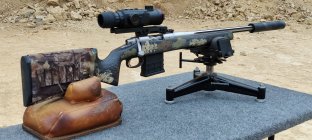

I just completed my 2nd 22-204 build. Needed something for Pdogs so built up an Aero Solus with Mullerworks 24" (12 twist) barrel.
Final load will be 53 Vmax over 27.5 gr H335, averaging 3380 FPS. Was just starting to see some primer flow with non-magnum primers at the 27.8 load.
