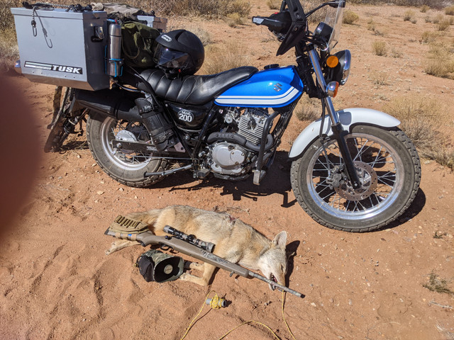

Last coyote I killed last season. Savage action and rechambered 223 barrel with Sightron-II 1.5-6x42 scope about the perfect calling rifle.
You will be pleasantly surprised with velocity, accuracy and absolutely knocking the dog snot out of coyotes. I personally use the 53rg Vmax, but the Berger's will work great and the 55gr Sierra HPBT will as well.

Bout that callin rig though haha. That’s sick. I need a bike now. Haha

Haha I saw that picture when I first started looking in to it. So 23-24" should keep the speed, I assume? I can go 26 but prefer not to, being that it'll have a can on it.

Thanks, that's what I want to hear! BTW, do you get 50 mpg with that hog? Cool little ride for hunting.
