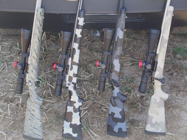

I guess I don't have a good pic of the one on the left below. This one has a 26" fluted MTU contour that shot the two groups above.
