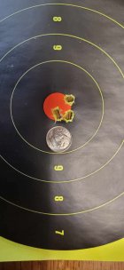

I had a factory Remington vssf ii in 204 that shot 39gr blitzkings into .5 easily with a few groups in the .3’s but definitely not its average. It shot the 40gr vmax closer to 3/4 and 32gr roughly the same. Im
Sure with a better set up it would be a good 1/2 moa gun with other bullets as well:

My cheap Thompson center venture ,factory 1/10 twist at 200 yards , suppressed with HSM factory 35 grain Berger match varmint flat base i'll shoot against anything that costs 3 times as much in the same caliber.
