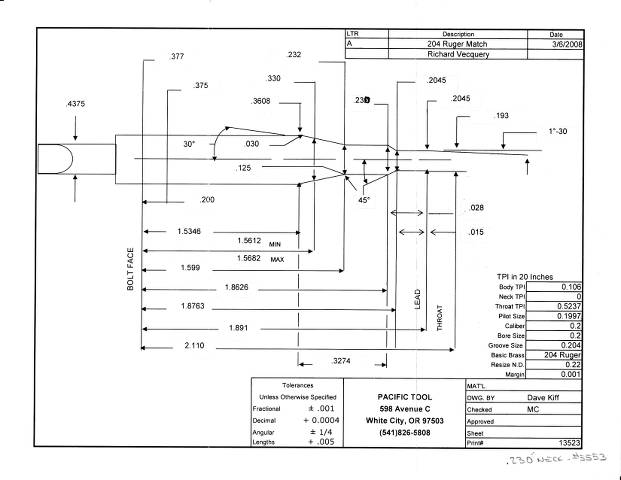

The .204 Ruger is a legit round but the SAAMI chamber can be problematic. If you do decide on doing a 204 it might be a good idea to check into a “match” chamber. A few barrel manufacturers are offering match prefits which essentially are made to Todd Kindler’s specs in his Terrific Twenties book
Is it just a shorter freebore ? The “ match “ chamber
Tommie do you know if Todd's 204 reamer design is zero freebore and .232 nk?
I know one reamer design i have seen is called " match" which was .232 at the nk junction and .230 at the end which in my opinion should be .232, dont know if it was Tod's design or not.
No, the TK match chamber tightens up all the dimensions, smaller neck dia, shorter FB to reach the lands. Here's the reamer I had PTG make for my 11T rat rifle:
For my reamer, I used a .230" neck. Loaded round neck dia runs .228" and has given me what could be called "match accuracy". If I was to do it over, I'd not change a thing. Only caveat is that once done, it's not advisable to shoot factory ammo in this chamber, only handloads developed for it.

I know the factory chambered 204's have a lot of FB. The CZ 527 204 Ruger I used to have a 32gr Vmax nearly was falling out of the neck before you could touch the lands and the Tikka I have now is nearly the same way. Fortunately, they still seem to shoot pretty well with all that FB and jumping them so far but I'd never have one chambered with a SAAMI spec reamer. I think somewhere around .030 FB or less would be plenty unless it was a fast twist build and you were going to shoot the much longer Berger 55's but generally most don't build 204 Ruger's to shoot the 55's.

as far as my reamer print goes, it's a PT&G "match" .050fb .232 neck.
