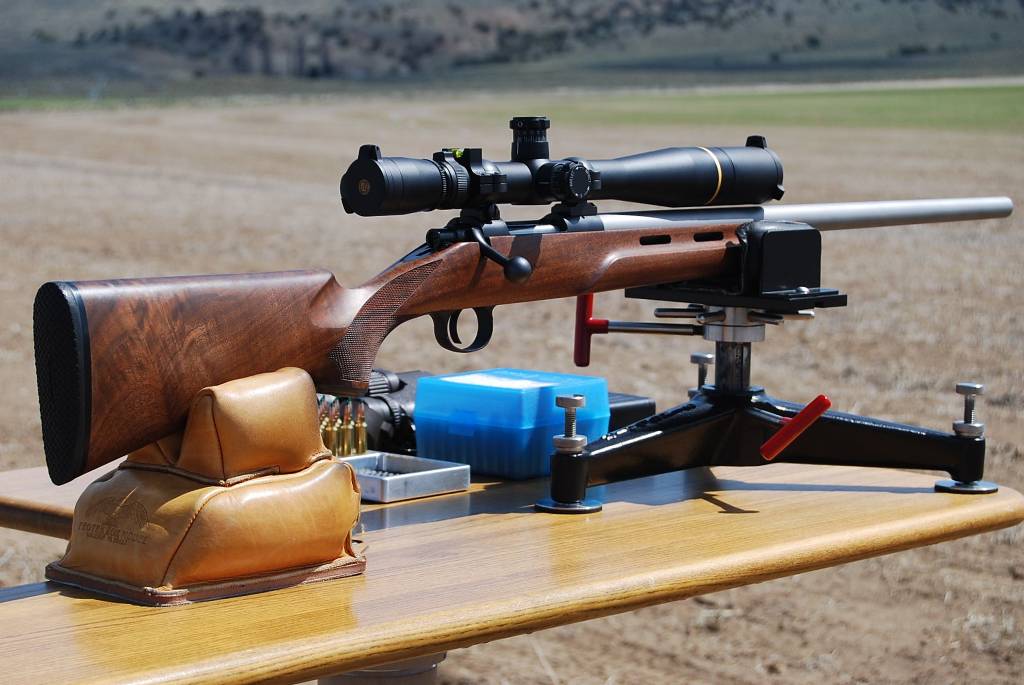

One of my chuck rifles in 204 is a Cooper MTV, all factory except for a Jard 10oz trigger. It shoots well for a factory rifle, so chucks here try to avoid it. I don't shoot much paper, but here's what it did during load development:
This rifle mainly gets used for ground squirrels in the alfalfa, and to that end, she does purty well:
