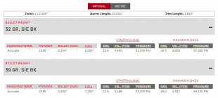

i was gifted a partial box to try (haven’t found any) by a member and picked a random charge that I read worked good (and it did) going around 3800fps

Like others, I easily get 3800 fps from my FCV and if a 20 cal will not shoot the 39 Sierras accurately, it's time for a new barrel.
Here is a charge I tried at random. I put 3 in same hole and pulled two cause guys next to me were mag dumping AK pistol as I was getting ready to fire
