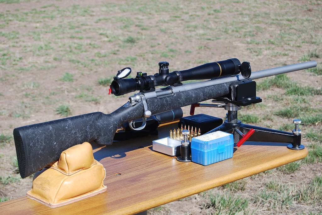

I built my 204RM (Ruger Match) using TK's reamer design but tweaked just a bit, to minimum freebore, having Pac-Nor do all the work; blueprint the action, supply/chamber/install a SS Super Match bbl in M700 varmint contour, 11 twist, 24" finished length. I had them also skim-bed it into the H-S Precision stock, Holland lug, Jewel trigger. Dave at PTG ground the reamer to my spec's.
Primary mission: Ground squirrels, PD's, occasional rock chuck. Would I change anything now after fielding it for six seasons? Absolutely NOT! It shoots both the 32's and 40's with no seeming preference, both shoot 1/4" or less.
My rat shooting crew coined her the "Silver Princess of Death" for the very impressive field performance she's shown in that time.

Not to hijack this thread but, Rick that is certainly a sweet rifle.
I have two XR100 rifles and am always pleased with how well they shoot factory ammo as well as handloads. I’m wondering if your reamer allows the use of factory ammo as well as your handloads. I’m sure like me you reload for your custom builds but in a pinch if you were heading out for a quick coyote hunt and only had a box of factory 204 would they function ok. Obviously it makes more sense to have enough handloads ready, but I think we all have been in a situation where going out or not could have been easily remedied by the ability to grab a box of ammo on the go.

Nice rifle Rick.
Matt
Thanks Matt, answer is 'no'. The 204 factory loads are all predicated on the very long freebore in the factory chamber, usually something like .120" and more in some I've measured. Todd's reamer design that I tweaked and tightened up a bit with .015" freebore, and a 'no-turn' neck of .230" pretty much negates any use of factory ammo.
But I do indeed handload for all my rifles, and almost all of them have never had a factory round fired in them. I've never been out of ammo on a rat shoot; it's both comforting and disturbing to bring home a couple of full .50 cal cans with 400 rnds/can after a rat shoot. Good to have for future outings, disturbing that I didn't get to shoot them all. Oh the horror! ;)
