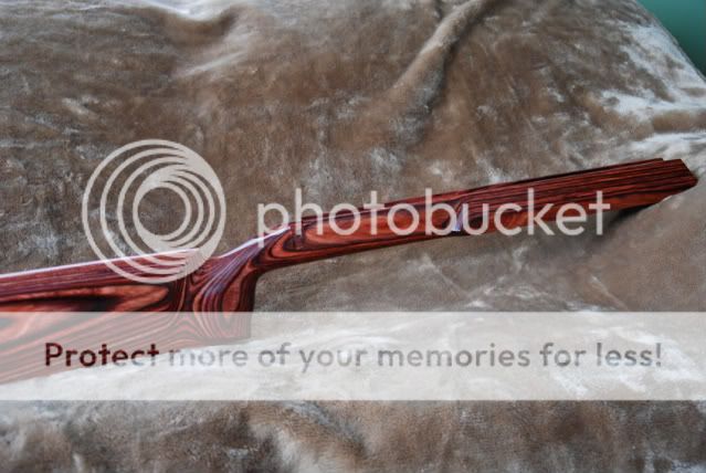

I have a Savage LRPV single shot .204 that is at the 'smith right now being transformed into a full on BR rig. Has a Leupold 35x on it for glass. With 35gn Bergers and 25.0gn of 10X I've shot several 1/4",and sub) groups with it. That is in stock set up. Not really expecting to compete with it but it should run with any other rig in the local fun matches.
I'm having it pillar bedded into a Shehane MBR Tracker rosewood stock. Next time around it'll get a new PacNor barrel and all the accurizing that goes with it. Also thinking of getting an 8 or 9 twist switch barrel so I can run the 50 or 55gn Bergers for some longer stuff.
Original setup and the new BR stock
