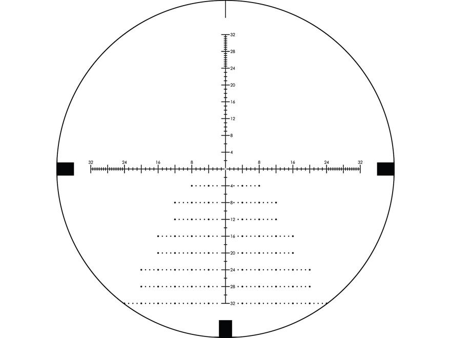

Get one of these and don't look back. Once you get it mounted, sighted in, and Chronied... go to their Ballistic Calculator, and then get ALL YOUR DROPS and WINDAGE for all those little lines and dashes. You can use this BDC Reticle or turn the turrets. With a 204, windage and drop will always be a factor... so you might as well get a scope that gives you MAXIMUM POTENTIAL.
http://www.vortexoptics.com/content/lrbc
Vortex Viper HS Long Range Rifle Scope 30mm Tube 6-24x 50mm Side Focus First Focal XLR Reticle Matte

EDIT.... I just found out that it has a EBR-1 Reticle... which is still good... but it's not the XLR that I like.

To each his own and certainly nothing against Vortex, but that is waaaay too much junk in the field of view for my liking. I much prefer zero stop with a simple reticle such as a dot and crank the knobs. If you are after running game mostly, you may want something like the Leupold Varmint Hunter reticle. As for power, it depends how far out you want to shoot. 3-15 should cover most situations. 5.5-22 if you're shooting small at 500 yards and beyond. Too much low end power in hunting situations is not a good thing IMHO.
