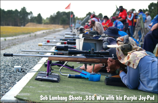

The Seb Pod-Pad could be tough to get in compliance. I see tracks forming as the sand settles away from the feet as the match goes on. I would have fill it up enough to not dent under the weight and movement of the rifle but still keep flat on top instead of bulging up.
Tracks forming in the ground wet or soft...

As mentioned earlier, does this new rule disallow the Seb Pod Pod?
I don't agree with it, but it seemingly would. I've never seen a pod pad that doesn't create something resembling tracks.

Look at what Seb's setup in the picture above, he's got short nap carpet on his Pod Pads. That looks to be completely in compliance with any interpretation at least to me. I may actually buy the pod pads to go this route.
edit for closeup:
