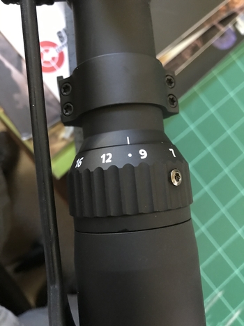

With the 2nd plane scope, I have the same reticle size all the time. With my MOAR reticle on the Nightforce set on the dot between 9 & 12 power, it allows me a quick calibration in my head if needed. The dot is around 10 power (+-). I don't have to go up to 20 power for the calibration.
