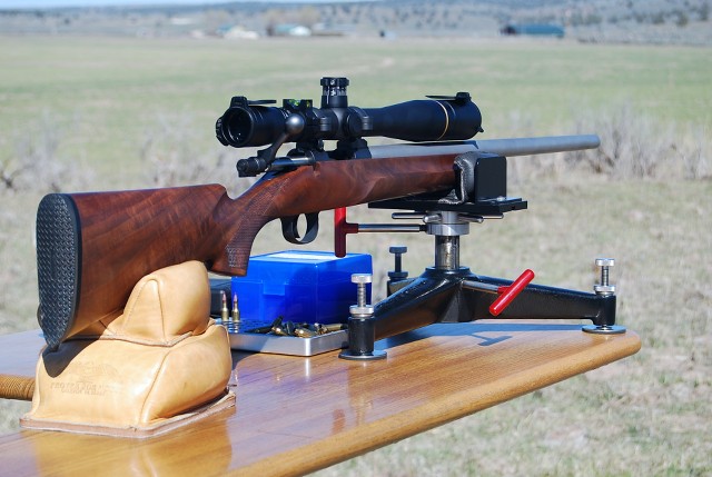

My 20VT on the bench having her way with Skippy and his pals.....
