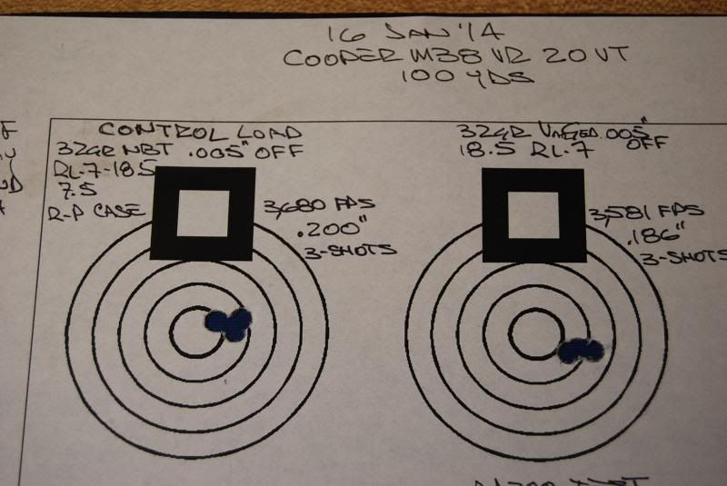

Here's some typical targets shot with my Cooper M38 VR using both Nosler 32gr BT's and 32gr Varmageddons during some recent range work:
AA2200 also shoots well in mine, but RL-7 is the top dawg in my rifle. :)
