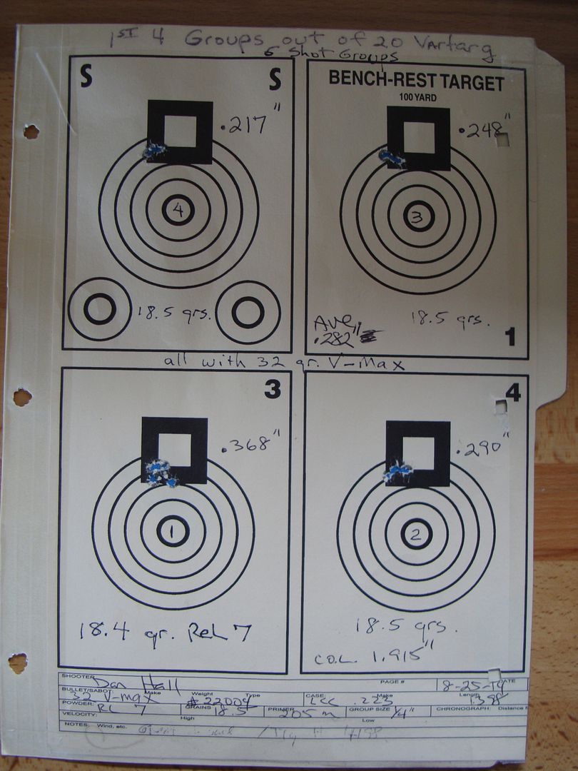

REL 7, 18.5 grains under 32 grain V-Max touching the rifling if you can. And try not to interfere with the rifle, don't touch the gun,except the trigger, if you can.
The groups just keep getting tighter and tighter. Dakota Predator and 18.5 grains REL 7, 32 grain V-Max. qx
