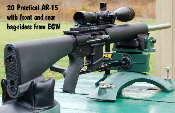

Well under 0.5" is possible, based on Whitley's experience. This assumes a good trigger and bag-riders front and rear, with good rests. (Unfortunately, most AR guys don't use proper rests).

EGW Bag-riders on AR:
