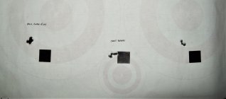

AA2200, X-Terminator (2230) and TAC with 32 gr. V-max in a XR-100/Lilja and a 24" BHW AR.
100 yds, 3/4" target paster holding on the left bottom corner. 5 shot groups, two sight changes with XR-100/Lilja. 24" BHW AR will not shoot quite this well, but everything is 3/4" or better.
Neither rifle changes much with different powder or load. I just loaded for 3950 Fps. to get speed and still easy on brass. They will shoot 4050+ fps.
I know ball powder isn't the most temp stable, but it flows through the measure like water for bulk loading. I have no problem developing loads at 55 degrees then shooting at 95+ degrees on prairie dog trips.
