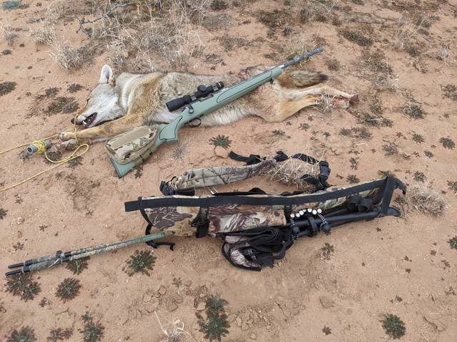

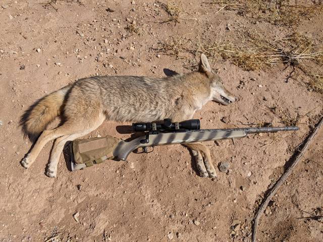

32gr V-max for varmints and 40gr NBT for coyotes. I've had some luck with Nosler 32gr HP's(discontinued) on coyotes also.
40's
32gr HP's
