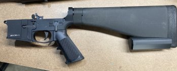

I’ve got 2 ARs in .20P. Unfortunately I don’t remember which one shot that group.
One has an Olympic Arms lower, the other is an 80% (from AMT I think). Both have Geissele High Speed National Match 2 stage triggers. Both have A2 stocks with 2” of extensions. One has a standard buffer, the other has a CTS buffer. The uppers are DPMS Lo Pro (heavy wall), don’t remember whose BCGs. Both barrels are 24”, one muzzle is .920” and the other is .850”. They are both 11 twist. I believe I got both from WOA.
Floater handguards are from Kreiger. Put Delrin bag riders on stock and handguard. Bought one, made one.
