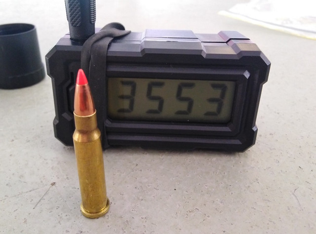

Standard PTG 20 Hornady Hornet chamber, 21 inch barrel, no long barrel required with Lil gun. OAL 1.780.
I have some Power Pro 300MP to test soon which may allow me to crack 3600fps......
I managed to push 40gr BT to 3135fps but the accuracy node was back at 3000fps.

Nosler appear to not anneal their hornet brass and primer pockets are a bit average too. I cracked a lot of brass in the first batch of fireforming but a butane torch fixed that issue. shot my first batch yesterday at the range.
A light load of 10.8gr Power Pro 300 pushed the 35gr Berger to 3020fps. With the cases now formed Ive got plenty of testing in the coming month.
