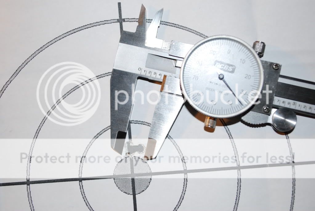

Figured I would toss up a pic. This was a group I shot when my Savage M12 LRPV in .204 ruger was new. About 20 shots down the tube.
Shot at 200 yards. Pretty damn good for an out of the box gun off of a bi-pod. ;D
