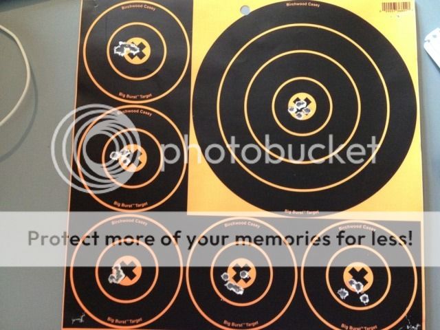

These are the first 30 shots out of my Bob Green built .20 VarTarg with a Rock Creek 1:12.
Remington 221 FB Brass, FL sized to 20VT, Remington 7 1/2 Primers.
Large Target - 5 shots to sight in using 32gr V-Max and 18.4gr of H4198 (.758 - .204 = .554)
Top Left - 5 shots 32gr V-Max and 18.0gr of H4198 (.715 - .204 = .511)
Left Middle - 5 shots 32gr V-Max and 18.2gr of H4198 (.526 - .204 = .322)
(For some reason, it looks like only 3 shots hit the paper. Can't explain that one.)
Bottom Left Corner - 5 shots 32gr V-Max and 18.4gr of H4198 (.505 - .204 = .301)
Bottom Center - 5 shots 32gr V-Max and 18.6gr of H4198 (.804 - .204 = .600)
Bottom Right - 5 shots 32gr V-Max and 18.8gr of H4198 (.931 - .204 = .727)
Average group size = .503
Hits just a hair over 3600fps.
Note: These are MY loads in MY gun so please, don't duplicate them.
