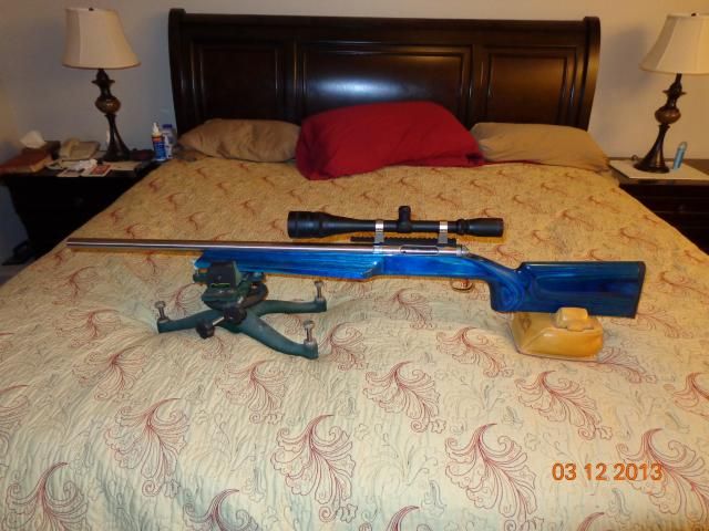

Here is a picture of my F class 6BR which I will put the 20 cal. barrel on.
