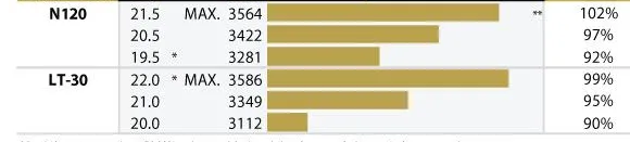

Here is 222Rem data with 40gr bullets from the same 20in bbl. Factory brass, just load and shoot.
The big difference is annealing. Trying to anneal the necks of 221 length cases without softening the case head is very tricky. Less difficult with the 222.
