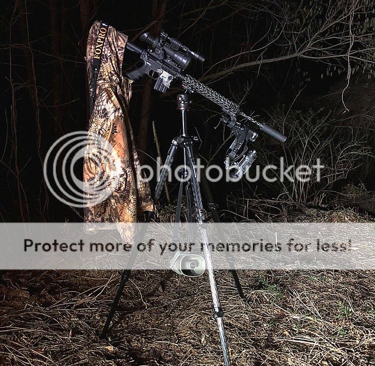

20/22 NOSLER
I AM NOT RESPONSIBLE FOR ANYONE SHOOTING ANY OF THESE LOADS IN THEIR OWN GUN.
My brothers Proof research carbon fiber 22in AR-15
Around 60 degrees outside when tested
Factory loaded 62 hp varmeggeddon was around 3000 and 55 gr ballistic tips were around 3200. I do not remember exact numbers
New nosler brass, H4895, 53gr varmeggeddon, BR4
22 nosler Velocity
53 grn/29grn powder
3311,3288,3314,3343
---THIS IS MAX POWDER CHARGE THAT NOSLER LISTS---
30 grn powder/ one hole group -- This is his load
3434,3410,3450,3422,3490
31grn powder
3643,3642, 3693,3638 - showing pressure signs
32 grn powder
3756,3738, - stopped shooting was massively over pressure
Also tried varget but it was impossible to get those kinds of speeds
[URL=http://s30.photobucket.com/user/Blaked33/media/IMG_6084_zpsykt2wtfa.jpeg.html][/URL]
[URL=http://s30.photobucket.com/user/Blaked33/media/IMG_6083_zpscw9qibc3.jpeg.html][/URL]
