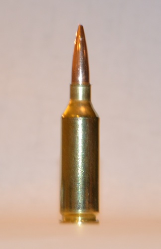

i'm thinking of setting up my encore in a long range(400-500yards). the barrel will be 24 -26 inches and .850 inches wide(pro hunter). i have a 20 vartarg(16 1/4"long mgm barrel), a 223 rem in savage model 12 so i am looking for something different. it could be a 20 tactical, 20 classic, 20 ppc, 224 Texas Trophy hunter , 22-6mm rem ack imp http://i55.photobucket.com/albums/g154/HotRodAl52/20Classic005.jpg

Sounds like you've got the medium to light stuff covered. I vote 224 TTH.

I would look at something with a .378 case head and a straight body and maybe even a 40 degree shoulder. This will keep bolt(not really a bolt) thrust as low as possible. The 40 degree shoulder is supposed to reduce case collapse and resultant excessive headspace on the hammer strike. That said I would look at a .20-.223AI, .223AI, .204, .22-.204 and the likes. Run a slow twist in either caliber to handle the heavier bullets to help with the wind. JMHO and food for thought. ;)
My gunsmith just finished up my second 22-204, Xr-100 action w/a 26" Broughton 5C 8 twist. 75 gr Amax are scooting right along at 3200fps and there's still have room for more. The only kicker is the most of the cartridges you listed have dies available. I had a Redding 204 FL Type S die opened up for the 22 cal and had a Forster 22 hornet micrometer seater reamed with my chamber reamer.
If you're wanting flat out hauling, the 224 TTH/22-6mm would fit the bill. My gunsmith shoots a 22-6mm w/ 75 gr amax and they're going about 3500 fps. It's his go to coyote gun.
