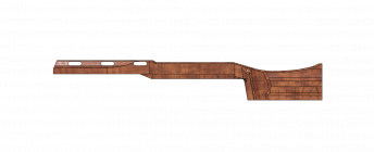

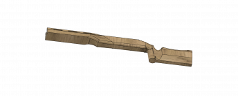

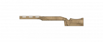

Screen captures of the 2 stocks below. Fusion 360.
Full Swoop Custom Stock Final v2 #2.pngStart of something new. Modified v2 #2.png
