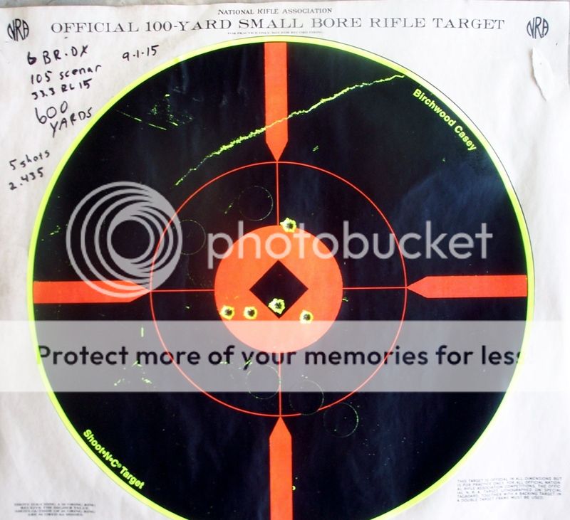

todays playing around took my 4 groove Krieger 8 twist 6BR-DX over the 2,000 round mark,,I usually just goof off and bang steel and shoot at small bottles of Tannerite and the like,,to mark 2,000 rounds I put 5 rounds on target at 600 and even with the throat stretched a bit it will at least still hold under 2.5 inches,,been a fun barrel and have a Brux getting done with same reamer
105 Scenar
33.3 RL15
BR4

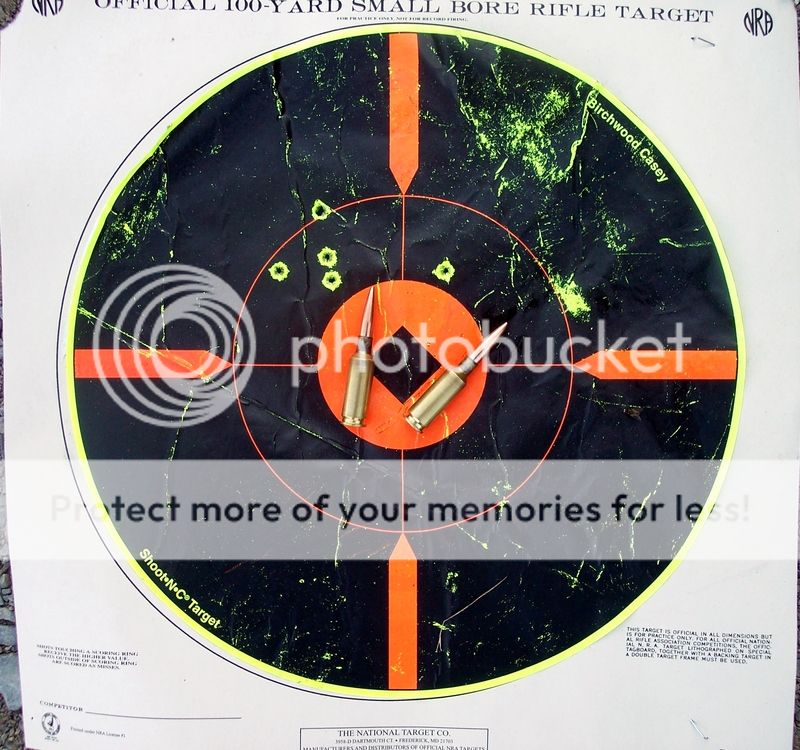

I am gonna start next barrel with 105 VLDs,,if it follows suit with this one and starts shooting the Scenar better after about 1500 rounds I may do the next with about a .185-.190 freebore and try the Scenars from the start,,,they seem to like a lot more jump than possible with the .138,,
with a new barrel throated to keep the 105 Scenar above the donut and have .040-.050 jump just might be the trick to beating the Dasher,,
