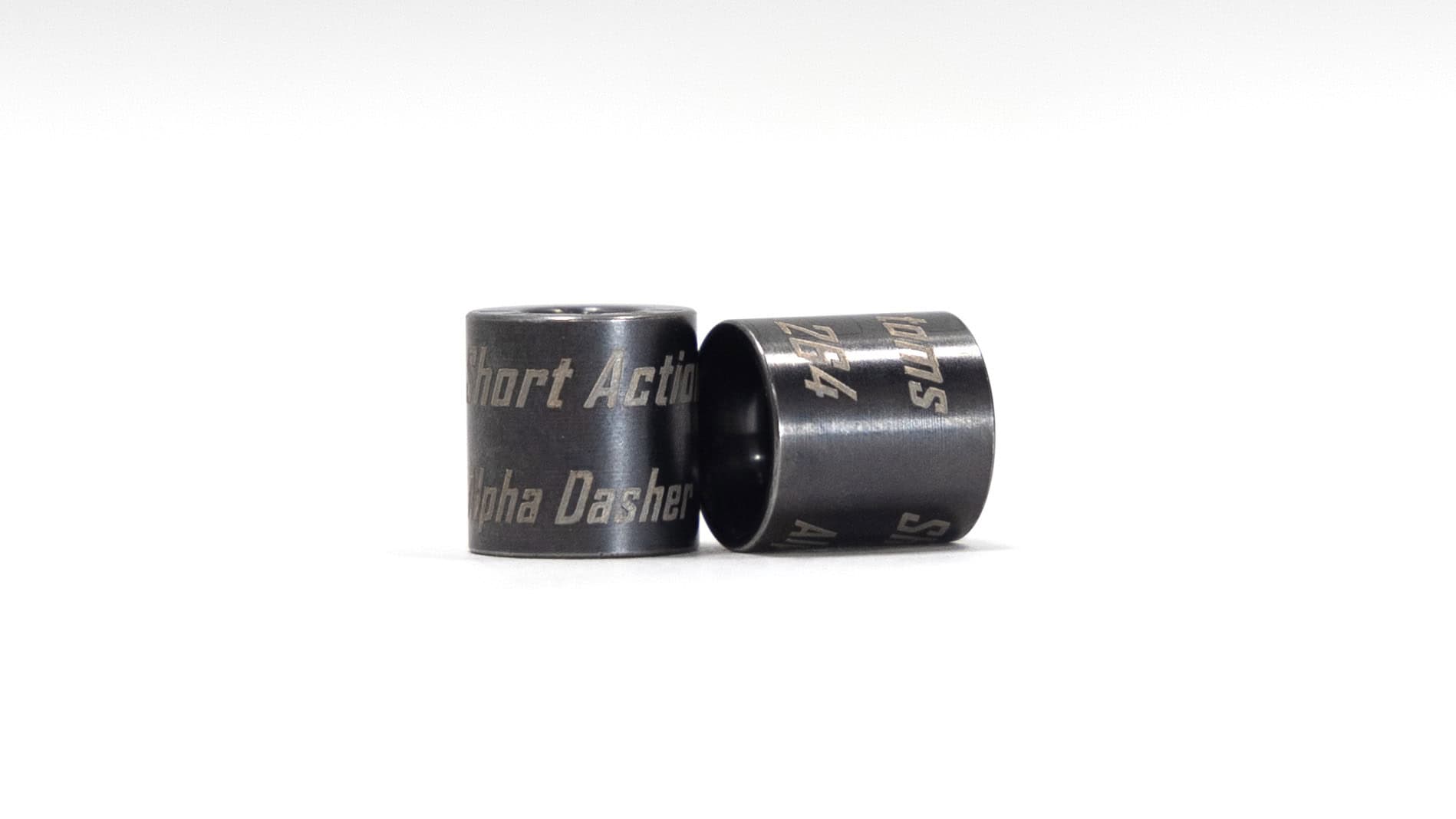

Need the correct neck/shoulder bushing for the Alpha Brass?
"Note: These Dasher Bushings are for chambers with a .060″ Neck / Shoulder Radius and a .000″ Shoulder / Body Radius. Not Alpha Legacy ® Chambers."
Correct bushing for Alpha Dasher-
"Note: “Alpha Dasher” bushings are specific to rifles chambered with Alpha Munitions Reamers. Only select “Alpha Dasher” if your rifle has an Alpha Dasher chamber."
There would seem to be 2 different Neck/shoulder Bushings?
Yes, I have the Alpha Dasher bushings. My chamber was cut with an Alpha reamer.
