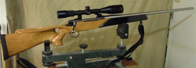

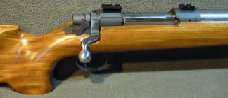

I currently have 4 that I did up myself. They were completely reworked and not a part on them are stock.... other than maybe the floorplate. Mine all wear Hart barrels, and I am currently building two more with kriegers. I just sold one in .308 Norma (which I kinda regret now!). The others are a 7mm Mag, 6.5-280 Imp, a .264 WM, just finishing a .280 Imp, and the .338 RUM is up next.
Mine all shoot 1/2" 5 shot groups after a little load development, and the 7 Mag goes from 1/4" to 1/2" depending on the temp with my current load.
They take a crap load of work, but when done up right are hard to beat IMO for anything other than a custom action.
Here's a photo of the Norma and the .264. Not the best photos, but they look extremely nice when done up properly. Don't mind the stock in the close up, it was a repurposed temp stock till I got my new one.
What kind of work did you do to the action?

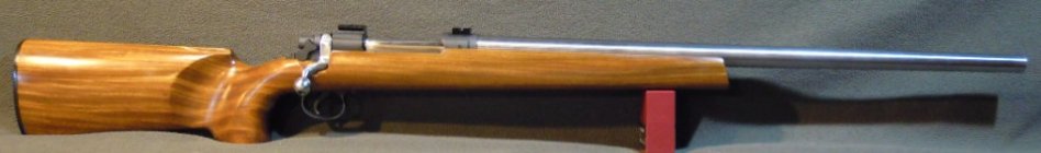

Here are 3 pics of my dads 308 Norma Mag with custom stock and Enfield 1917 action. It only weights 8.5lbs which only 1lb heavier then a Rem 700 bdl. It has one of the most comfortable stocks in our safe. I love the cheek rest it feels like your part of the rifle.
I do notice the differnce in bolt style's though. Mine is more of Z looking bolt handle where yours is straighter. Is that cause you have different vintage of action or a custom design?
OK, well, it mainly depends on how you get it and what has been done before. For arguments sake I'll describe the work being done from a bone stock 1917 original action.
-Rear sight ears removed.
-Oval filled/ silver soldered if present.
-Rear receiver ring contoured to Rem Mod 30 or Rem 700 contour.
-Firing pin lightened
-New speedlock spring added.
-Cock on open cocking piece added.
-New Trigger added, Timney/Dayton Trister, and if your lucky a Canjar.
-Magazine box modified, usually shortend.
-Trigger guard straightened, and trigger loop narrowed if preferd.
-Safety lever narrowed/lightend.
-Rear or action contoured where the old bolt stop spring stop use to be. Usually removed and contoured.
-Drilled and tapped.
-Front of reveiver ring squared.
-Lugs lapped. (There is a 2 degree cant on the lugs, so it's almost impossible to square them without expensive tooling.
-Charging clips removed off of front of rear reveiver ring.
-Loading ramp usually polished.
-Feeding rails modified if magnum conversion.
-P14 bolt or modified 1917 bolt to accept magnum case.
-Extractors usually need to be messed with to allow proper feeding.
-Ejectors sometimes need a new coil spring added if old one is broken.
-Bolt handle straightend.
-Bluing and polishing
I'm sure I forgot a few things, but it ends up being fairly involved, and many of these step need to be done correctly otherwise each function may not work properly.
As far as the bolt handle goes, yes mine are usually modified to go straight. Yours in in the original configuration. There is no functional difference, just looks.
I'm currently working on a Pattern 14 that is almost ready for a barrel, but I'm guessing I have about 20 hours into it so far and it still needs a little work
Hope that answers your question.

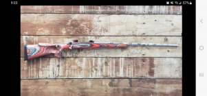

I know this is an old thread, but here's my 1917 hunting gun. Converted to COO and new fp spring, kept the belly, new criterion barrel, timney trigger, Boyd's stock, NOS Redfield scope base for a p17 "flat top", kept it .30-'06 as intended. Good shooting gun, but its heavy for more than a few miles of walking. About 11lbs I think.
