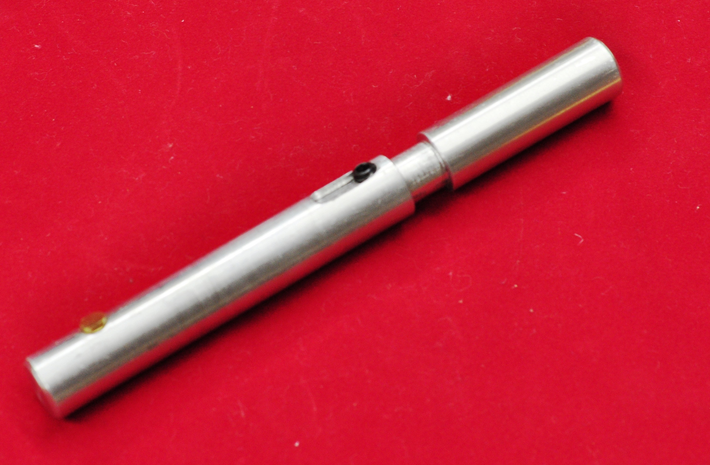

1860 Henry Spring Loaded Magazine Follower
It has been discussed many times on this forum and other about the possibility of the spring loaded magazine follower being released accidentally and the follower slamming into the cartridges in the magazine, setting them off with bullets against primers. There are reported cases of this happening at loading tables and during a stage when the magazine follower gets hung up on a prop and suddenly released with impending doom following.
The second issue with the 1860 Henry when used in Cowboy Action Shooting is the possibility of the magazine follower hitting the shooters hand and impeding the loading of the last three or four rounds depending on where the off hand is holding the barrel.
CAS folks will cut a piece of 3/8" dowel about 4.5" long and insert it after the ten rounds are loaded, thereby creating room for the off hand and allowing unimpeded loading of the final three or four rounds.
I decided to "Kill Two Birds With One Stone" and build an extended magazine follower that limits the possibility of #1 and serves the same purpose as #2
I've detailed the fabrication on my web site for those with access to a lathe that might want to make one or have a machinist friend who owes them a favor whip one up.
