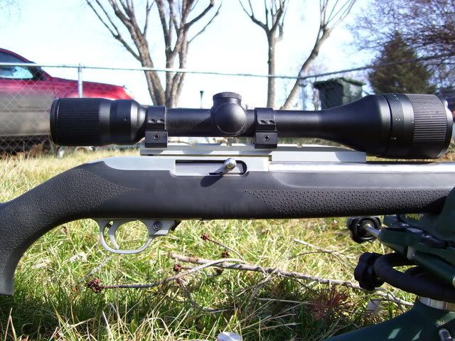

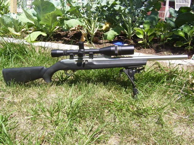

Yep, I got the kit directly from and shortly after Volquartsen offered the M2 conversion and it was still the only kit available, that I was aware of, since the cartridge was still fairly new at the time. The barrel is a beefy 18" .925" straight cylinder and the Hogue stock fits that contour like a glove, I'm not sure that I would call it truly floated because there is some flex in the forend when I'm using a bi-pod, but I haven't noticed any detriment to the accuracy. Overall I think the stock is pretty good for the gun, and its super comfortable to shoot and handles well from any position. I haven't kept a round count on the gun, but I have had it for few years and if I had to guess I probably am getting close to a couple thousand rounds though it.
